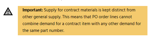

My involvement with Epicor began in 2009, and I’m not all familiar with planning contracts. I saw this note in the applications help, and I’m wondering if it should cause concern. Not sure what they mean by “general supply”. Some of our long lead time parts (especially PC board assemblies) are widely used across many product groups, and many are also sold on parts orders. If we had to link thousands of sales and parts orders to a contract for each long lead time part, that could be prohibitive.
My understanding is that buying against a Planning Contract is almost like reserving the material/part. When you receive it, you have to receive it to a “Contract Bin”… so it is kept aside (system-wise) from the “general supply”.
So, what I THINK this warning is saying is that… if you need qty (2) for your Planning Contract… but also want to buy qty (8) for your general warehouse supply… then you may need (2) PO Lines for the same part. you can’t just have (1) PO Line for Qty (10).
The PLUS side of this, is the qty (2) you linked to the Contract… being received into its own Contract Bin, will also show up separately when looking at stock/inventory. So, if the PC Board is purchased on a different sales order, your personnel should be able to identify that they can’t take the boards from a Contract bin. Only from a standard warehouse bin location.
Again, not overly experienced using this… I don’t know if the system will absolutely refuse to let you ship a “contract” part against another order… and of course, nothing can stop someone from physically taking the part and shipping it anyway.

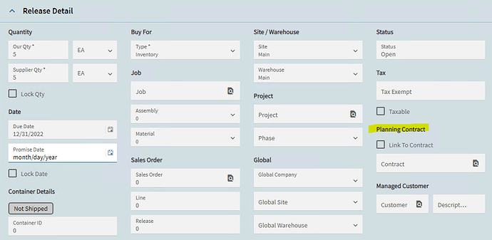

Just for clarification, you can add a Planning Contract to the Line or a Release
