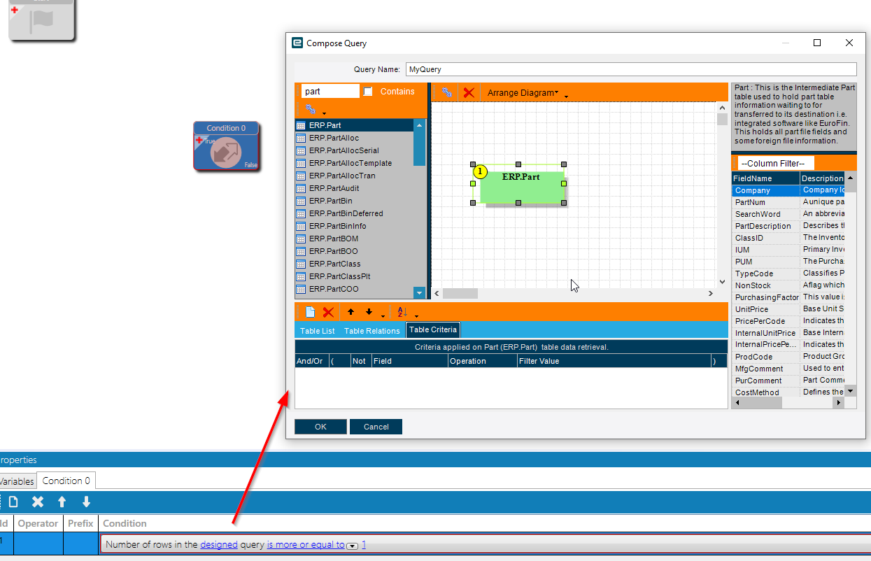

What is the best way to trigger a message when entering a Phantom part on an order line to to verify on the Part table Phantom BOM is true? When I select the Condition widget, it does not have the Part table so which widget would I use to make the condition statement to look at the Part table?
Or in general, if we ever want to do a Condition on a table not referenced in the Directive Business Object, what is the best approach?
I added the Part table with a criteria PhantomBOM = true but it is trigger on all parts. My number of rows is set at the default âis more or equal to 1â. Am I missing something where it validates against the Part being entered if it is a PhnatomBOM?
Yeah, you have to cut it down to the part in the TT record. However, there is a bug where if you join to the TT table, it can cause a major slow down. So what you should do, is use the TT table to populate a variable, then in the query, filter the table by that variable.
