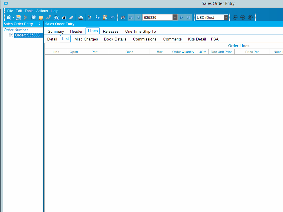

I have a user that would like the tab to reamin on “List” when clicking new line , rather than jumping back to the detail tab.
Anyone have any ideas how to accomplish this? For the time being, I advised the user could add new order lines in the grid on the Summary tab, but I’m just curious if this aspect can be controlled as well.

I was able to move the Lines tab to the first tab and the list tab to the first tab in the sub sheet. I then saved layouts and the screen opens to the lines entry.
Other option is move the List tab to the first tab in the lines tab and leave the lines tab position in the current location.
I moved the items around and selected Tools > Save Layouts. Closed out of Epicor and reopened. Then opened the form. The Summary tab defaults. Start the sales order and then move to the lines tab and the list is default showing because it is first.
