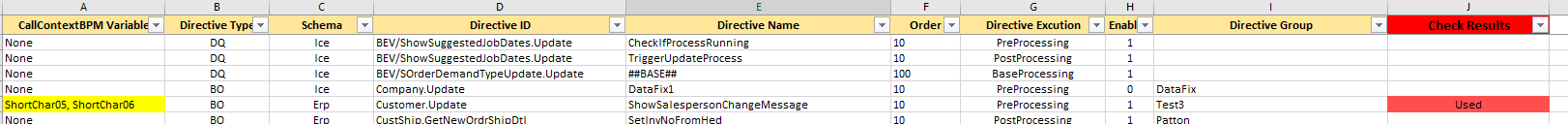

is there a command to create my own BPM call variable, i.e. instead of using CallContextBPM variables, the reason for that is, to avoid variable using overlap, up to now 177 BPM’s and 73 Customization which these variables might be used within, i had to create an Excel Master file to map out the use of these variables, it will be a great feature to have in Epicor to identify that on the relevent UI forms or even state them on an ice table

we do clear them, but there is cases when i needed to use them as triggers for other BPM’s -depends on the need- and user can run two UI using the same variables, thereby one of them will fail, also 177 BPM’s include Method, Data, and U-BAQ, we do have load of controls on our UI, that is why i would like to start creating my own BPM/Customization variables, so could you please elaborate a bit about storing information in session ?
do you mean this :
