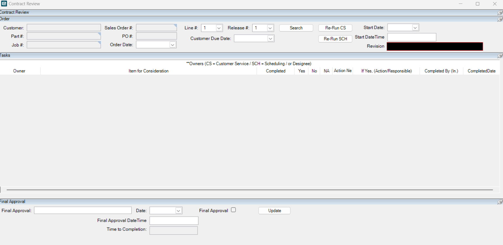

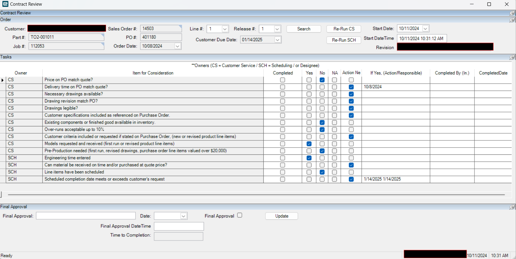

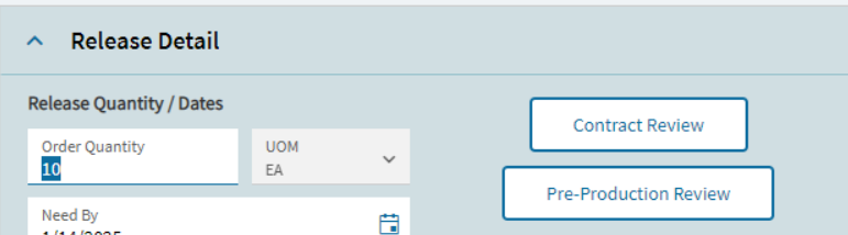

I’m trying to pass information from kinetic sales order entry to a classic form that was made before my time. Currently I’ve gotten it to open but it is blank as opposed to the classic to classic which opens correctly. Would this be as simple as adding parameters to app-open in application studio?
Classic Picture 1

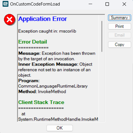

It looks like the issue is with the classic customization Form_Load. It is erroring out but I’m not entirely sure what needs changed.
Screenshot 2024-10-11 111819
