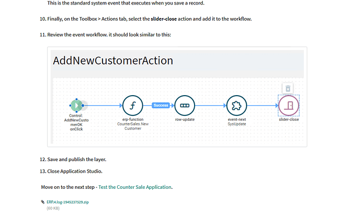

I don’t think that is possible right now using erp-function event action.
Suggest you use the rest-erp event action instead, and setup the dataview details on the Request Arguments.

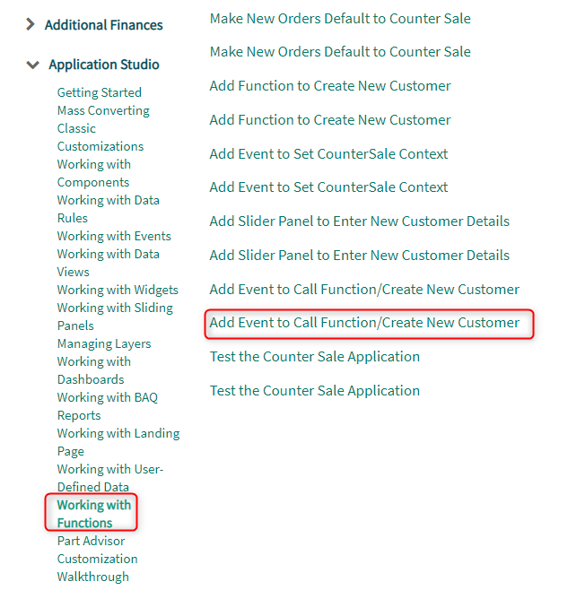

AppStudio Help has an example of calling a EFx using the REST-ERP action.

It seems the documentation has been updated to use the ERP-FUNCTION widget now. Any chance you can share a copy of the original or another example?
@Callum_Stott I just tried passing a dataset to an EFx using the REST-ERP.

I thought Timothy Schilling had an example of this, have you reached out to him? I feel like we did something similar at insights, but not exactly this.
He said he would always respond because he always checks his email.
If you don’t have his email let me know!
I didn’t, no. I actually went a completely different direction.
