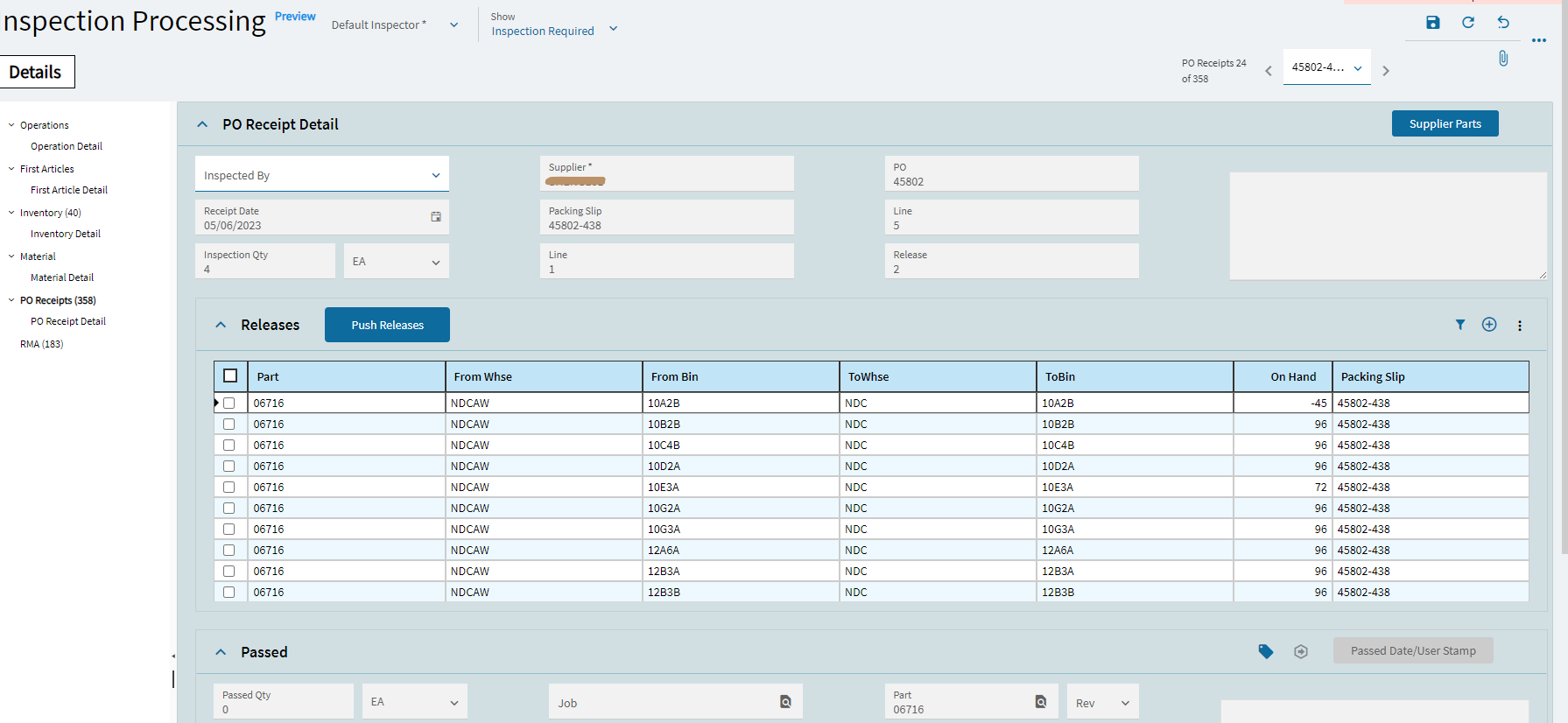

Hi, I have a grid and dataview within Inspection Processing which shows where all the stock from the inspection record is located.
I also have a button which when clicked runs a fucntion to do a STK-STK move from whse to whse in the same bin which allows us to sell the product.
When i click the button only the top row of the grid is passed through the function.
When there is only one record this works perfectly, the inventory transfer works and then the data view is refreshed but with more than one row in the data view the first record is run through the function but the grid also doesnt update it leaves the row in the dataview meaning when you click the button again the same inventory transfer happens.
DataView & Grid:

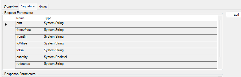

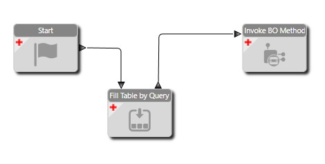

Function: Populates the table based on the functions parameters then runs the CommitTransfer BO.
I am unsure on how to send all rows from the data view to the function and then have the dataview/grid refresh so it removes the rows once they are moved (they do disapear from the underlying BAQ)

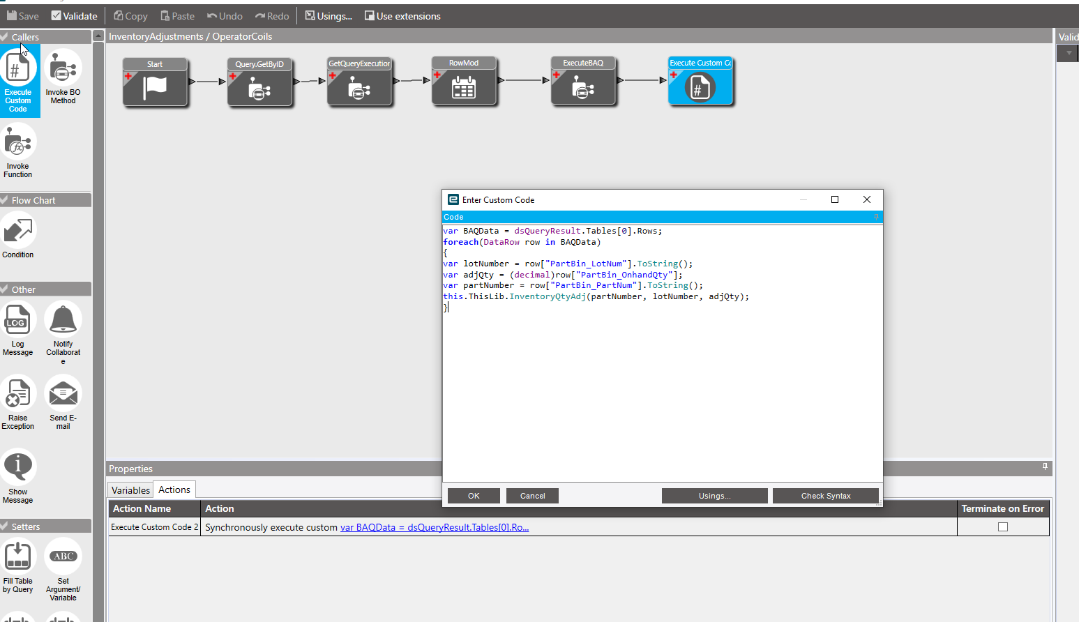

Not sure if this will work but I have a few instances where I just call the BAQ in the function then use a custom code widget to go through the returned rows and process another function for each row. A for each widget would be cool. I thought about trying a condition with an incrementing variable for each row also.
