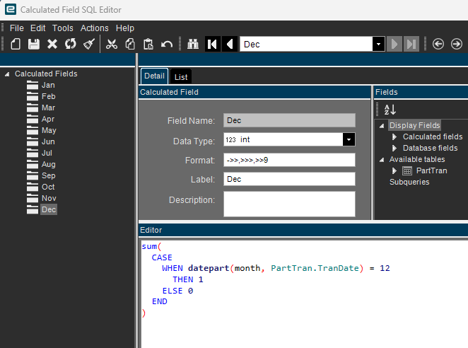

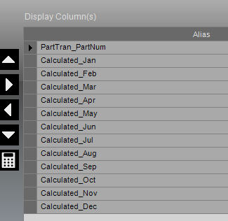

You can make 12 calculated fields,
Then in each field’s code, you can put this for the corresponding month number:
Keep in mind this doesn’t take into account years. It will count all occurrences, doesn’t matter which year it is. You may have to give it a date range if you want to get only this year.
sum(
  CASE
    WHEN datepart(month, PartTran.TranDate) = 12 /*enter month number here*/
      THEN 1
    ELSE 0
  END

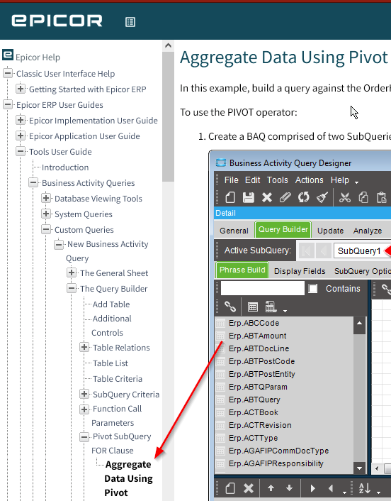

There is a guide in Epicor help on how to do a pivot which I believe is what you want
