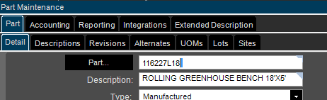

What is Epicor’s strategy with trailing spaces on part numbers? We have about 40 partnums that have a trailing space on it, but Epicor seems to treat them the same as without a trailing space.
Ex: BAQ query shows "116227L18 " as the part number with the trailing space. When I go to part entry, I entered “116227L18” and clicked tab. It pulls in the part with the trailing space!
We’ve marked our parts with leading spaces as inactive, and created correcting part numbers for those. But for the trailing space, I tried creating a new part with just “116227L18” and Epicor barks that the part number exists already…
Should we just ignore the trailing space part numbers, since they can’t seem to be fixed?
