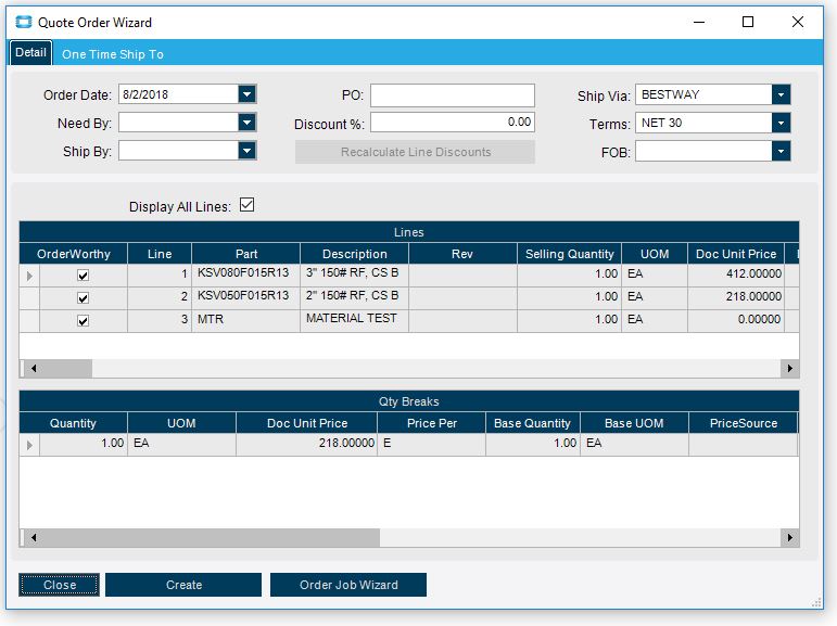

i.e.: Quote has 10 Line Items, but I want to be able to select only 5 of the Line Items when converting to a sales order.

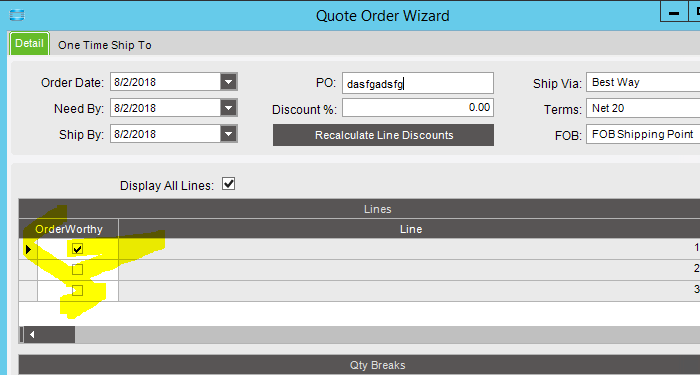

I don’t think you need to customize anything to do this. Just only select the lines you want to bring over when converting a quote to an order. In the box that pops up when you push it, just uncheck the lines you dont want.

However, although 3 of 3 lines are shown in my example, I cannot uncheck any of the boxes.
