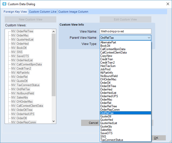

Even though I have the Part Adapter attached, the PartRev doesn’t show up in the Parent View Name list…

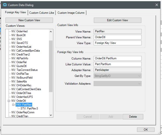

See if this helps. I should have named the FKV as Part and STV as PartRev, but you get the idea.
FKV:
STV:
Though I was able to revamp the code sample that Chris provided, it was the FKV examples that Theodore showed that did the trick, without having to write extra code. Thanks for all the help!
