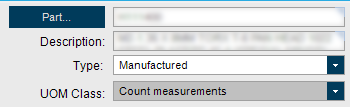

Once a part has been used in any type of transaction, changing the UOM is not possible, correct?
In the image above, the Factor of 0.001 is supposed to be 0.00048. However, we are unable to change it, and the override checkbox doesn’t work. I assume this is because we have orders, jobs, etc., all tied to that already.

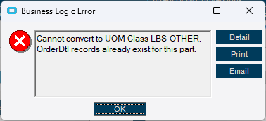

When I tried to do a UOM Conversion from the existing UOM Class to the new UOM Class, I am greeted with this error.
Once again, that confirms my suspicions that we cannot change that UOM. If that is the case, what other options are there in this situation? Do we need to ‘rollback’ everything done to with that part (orders, MFG Jobs, labor transactions, etc.) just to change the non-primary UOM?

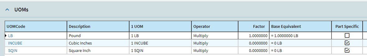

Dual UOM is basically a pass through UOM Class. You create the UOM Class with whatever you want your base UOM to be. In your case, it looks like EA is your base. Then you would add the Pounds UOM to the Class and set it as Part Specific. Put the Dual UOM on the Part Attributes page and the new UOM will appear in Part UOM page. Then you can set the conversion on it.

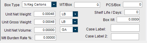

You mean these fields:
Yes, they are in use…(I have a feeling you are going somewhere with that question)

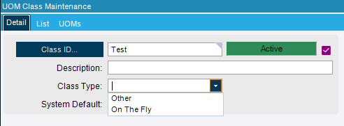

Did you create an Other UOM Class or a Dual UOM Class? It sounds like you created an Other.

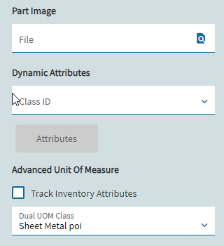

When you have created a Part that has the same Base UOM as a Dual UOM Class, the Dual UOM Class field opens up on the Attributes tab.
Then when you go to the Part UOM, you will see the UOMs that were added through the Dual UOM Class.
So, the Dual UOM is separate from the UOM Class you chose on the Part. It basically allows you to add another UOM Class to your part if you messed something up.
Where I was going with my question was, do you really need to do the conversion? I guess I am not understanding why you need the weight as I am assuming you sell in eaches. Is the weight needed for your methods?
Yes - It is my understanding that all of our Outside Processing for these is done by weight, while our internal processing is done by count.
Looking at your screenshots, I am wondering if Dual UOM was added after 10.2.400.22, which is the version we are on here. When I go to create a new UOM Class, the only 2 types I have are “Other” and “On The Fly”.
Yeah, must not be in that version. That stinks because that would have solved your issue.
I would look to see if there is a way to do what you need with the Weight field on the Part.
