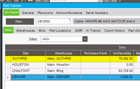

On Part Tracker, the On Hand -> Sites tab shows a QOH for one site that is incorrect.
Switching to the On Hand -> Warehouses tab, shows the correct QOH
The On Hand -> Bins tab is correct too.
Any idea why this is?

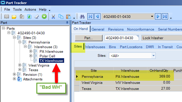

We are on 10.1.600.5 and are experiencing some of this too See screenshots below where we’re getting TX QOH added to our PA QOH. It has happened because somehow the system has added a “bad warehouse” of TX Main to our PA site. We do not have shared warehouses. Your Guthrie site has the 63,728 from Denver in it. It shows up incorrectly in timephase too and i expect MRP might be using bad number.
I have 2 suspicions. Either it’s due to PO suggestions or it’s due to RMA processing, maybe “move checkbox”.
Our PO suggestions since going live on this version have been a nightmare (Epicor SCR208390) where 90% of our suggestions for other sites get assigned to be bought for the correct site but have TX Main warehouse on them. I suspect that when a PO is cut and the buyer doesn’t change the PO release to the correct site warehouse and the part is received in, this “bad warehouse” is made in wrong plant. I am testing 10.1.600.20 where it SCR208390 has been fixed, and so far so good. At the end of it, I’m going to have to try and figure out how to get rid of the bad warehouses on some of these parts however
RMA processing… all of our parts with this problem have at one time or another hit RMA processing over the years. I can no longer get back to my E9 database to see if we had this problem before upgrade. We have had some issues with “request move” checkboxes causing downstream problems, either on RMA receipt entry or disposition of RMA to inventory.

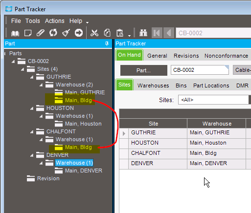

Nancy - I expanded the tree view, and see what you’re saying.
Under the Guthrie Site, (2) warehouse show. The second actually being the lone Warehouse for our CHALFONT site.
Since the QOH reported for GUTH (when viewing the Sites tab) is equal to the sum of the QOH at the GUTH and CHAL sites, I’d doubt its a lone odd record or two (like an RMA, or arrived but not received, etc …)
I double checked, an ther is just the one warehouse for the GUTH site, and none of the sites are setup for any warehouse sharing.

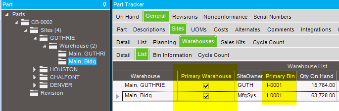

A more detailed look at the Part Tracker shows site GUTH with 2 warehouses, when it really only has 1. The odd thing is that both are designated “Primary Warehouse”, and have the same bin ID

So what we’re seeing in your Part Tracker is that the GUTHRIE site has a CHALFONT Warehouse listed as an available Warehouse for this Part for this Site. Is that physically correct (or even possible?)
And it’s really odd that they’re both marked Primary. In my One Site setup, I’m constrained to a single Primary Warehouse. If I check another Primary Warehouse, it unchecks the current Primary Warehouse. I can’t speak to whether a Multi Site setup would allow multiple Primary Warehouses, but you’d think that would completely defeat the purpose of a Primary Warehouse for a Site, right?
Can you change the state of the two Primary Warehouse checkboxes to the varying combinations of checked/unchecked and save between each change? Does it bark at you with any particular combination?

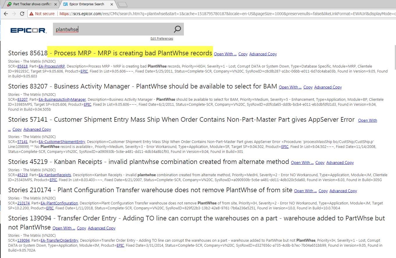

I looked up Epicor SCRs and see some historical issues with PlantWhse, but nothing that looks applicable in E10. I wonder what would happen if I deleted these bad PlantWhse records…

We are running into exactly the same issue. Epicor provided a fix program, but no insight as to why this is happening (want us in a vanilla environment on the latest version to see if we can replicate it at will and let them know what is causing it).
Glad to see we are not the only one with this issue. The fix program works (one off data fix), but I want to get out of the business of running a fix every day. On a given day, I’ve seen anywhere from 3 to 38 bad records created. So far, nothing recent in the part transactions for any of these parts when this comes up.
