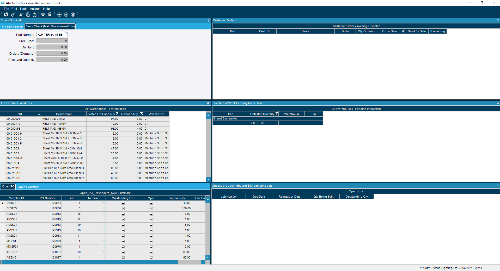

Hello All,
I am having problems with this part tracker dashboard made out of BAQ’s there all connected but when i load the dashboard it shows information in tested stock and container which i dont want to see only the data relating to the part i enter at the top however when the part does not pull anything through when i type it in press tab or even press refresh
This might be an issue with the properties and customization of the tracker. How are they set?
If the data is not showing the way you want then I would think it is a BAQ and linkage issue.
Are these separate BAQ’s connected with publish and subscribe? you may need more than one field published and subscribed to limit what you see.
Or is it one BAQ with different dashboard views? Then I would check the BAQ table links.
Try enabling the “refresh all” button on the dashboard. Sometimes the individual queries don’t all update, depending on which one is active when you hit the refresh.
