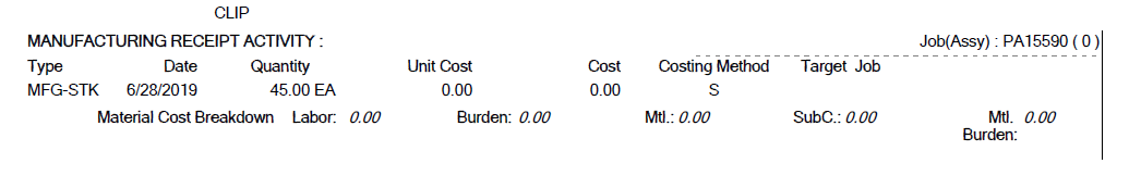

What shows on the WIP Recon report for just that job?
This information?
Yes. Was that limited to just one job?
Can you show the details with the transaction types?
There should be a pair of MFG-STK transactions. One to credit WIP, and it’s match to an Inventory account. Now that I look again, you don’t seem to have any trans that hit the Inventory account.

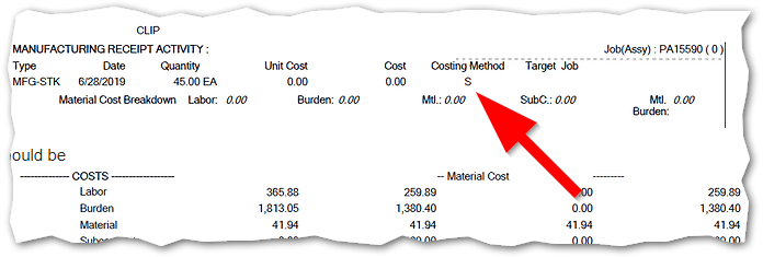

I understand but the process was followed correctly. Received into inventory then closed. I had them redo the process to make sure but the full amount went to variance. I think that part number was setup as std costing but we use avg. Looking into that.
should be

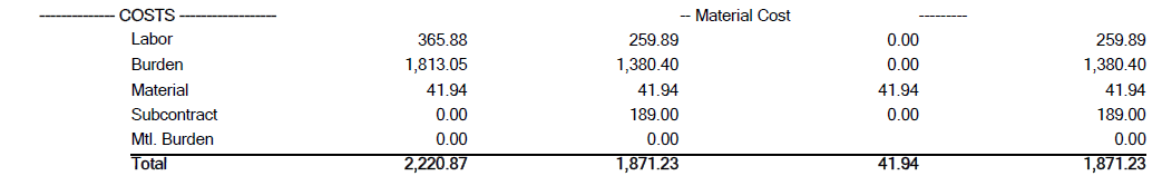

When looking at the transactions. It all goes to variance instead of following the parts. Exactly like the route if we did not receive these in before closing job. I think the costing method of S when the company is setup of avg is my culprit? Any thoughts on that?
It is definitely due to the cost method
The costs in WIP, minus the StdCost, are what end up in VAR. Since the Std Cost is zero. The entire cost goes to VAR.
