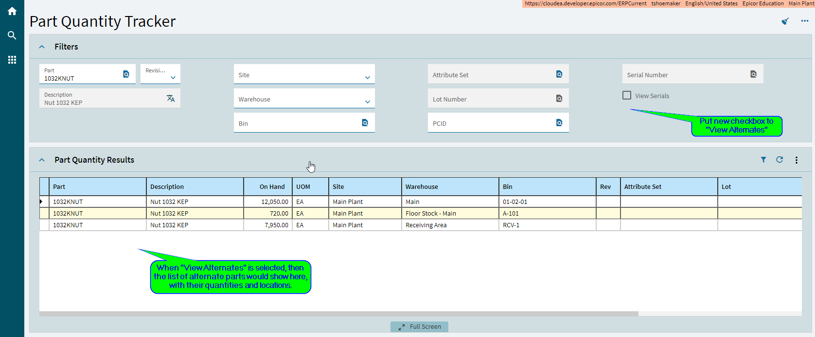

Well… we need to enhance the new Part Quantity Tracker to support this. I have added Epicor Idea: KIN-I-4964
I like that idea!
