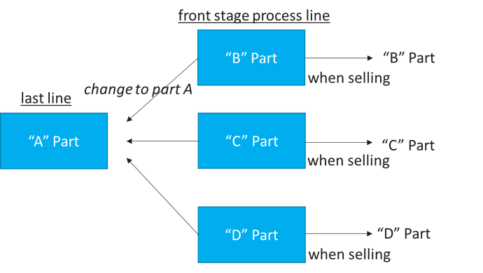

I interpret your drawing as part A having three revisions (or one revision with three alternate methods) using B, C, and D as materials. B, C, and D could be made to and consumed or sold from inventory, or they could be make to order when selling and make to job when making an A. I don’t understand your question because I don’t know how to not change the part number to A. AFAIK, the job that makes a B into an A could not have B as its output part. MoMs cannot be circular.
That’s the way I saw it too. You can make part B and either sell it or send it to a job to combine with part C and D to sell part A

B, C, and D have different manufacturing methods and raw materials. But in the last line (A) it is the same part. So the last line asks for the same part number. In the previous line, we considered manufacturing all of them with A part numbers, but since each is sold separately, the part numbers must be distinguished.
It seems that my drawing made it difficult to understand. I simply want to know if there is a feature to change the part number without using Qty Adjustment. Some people I know say there is no such feature.
If I understand correctly, your last line represents making an A with a B, C, or D as a material input. Why does the part number of the material matter? It seems that A is what is being sold or inventoried after that process. At that point, it doesn’t matter what the inputs were.

So do you have 3 BOM revisions for part A?? one that consumes part B, one that consumes part c and one that consumes part D?? If this is what you have then the problem is ensuring you create jobs for part A using the correct revision.
That’s not the case. There is one BOM for Part A. In this last line, whether it is part B, part C, or part D, one of them is used as raw material. For the last line, one of B, C, and D parts is selected and used as a raw material. It is usually used with the largest quantity first. Part B, part C, or part D does not differ in characteristics and is not a revision issue. Part B, part C, or part D are all the same raw material.

I didn’t think of scrap and salvage. Is it something like that, @pilio.lee? You can use small piece B, or you can use large piece D and salvage a B from the scrap?

So I take this as
  • You can sell part B by itself, or C or D
  • You also sell part A; it consists of ONE of the following:
    • Part B, with components of B1, B2, B3, etc.
    • Part C, with components of C1, C2, C3, etc.
    • Part D, with components of D1, D2, D3, etc.
  • Choice of using B,C or D is effectively arbitrary. You said they use the highest quantity first, but it’s not like site B uses part B and site C uses part C. If it was, I had an idea with Alt MOMs.
If these were tied to sales orders, there is a way to “use part revision.” Or configurator, as was mentioned.
The issue being discussed is already running using a part revision. That’s why I said the first example was wrong and made it difficult for you to understand. Sorry to confuse you.
