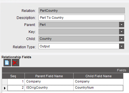

Would this be the correct way to setup this relationship?

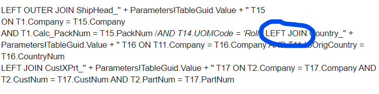

I’m not familiar with Intrastat. I’ve noticed that in the One Time Ship (OTS) Country it’s stored as the CountryNum. And I had to link up to the Country table on the CountryNum field to get the Country name (Description). As far as the ISOrigCountry, I’m not sure what that is or what it’s tied to. But you’re setting it up correctly from what I can tell. you said LEFT JOIN and I think that should be LEFT OUTER JOIN.
What part of the query are you referring to that should be LEFT OUTER JOIN and not LEFT JOIN?
Is there a way in the expression to say something similar to: represent the ID field as the description so it replaces it?
Unfortunately that did not change anything
Should I still use the ISOrigCountry field or would adding the OUTER mean I need to use the new Country_Description field?
I guess LEFT JOIN should work just the same as LEFT OUTER JOIN. I didn’t realize that. I just noticed it was different than the other joins in that query. So my apologies for that.
As I mentioned earlier, I don’t know what ISOrigCountry is referring to. Whatever you’re trying to do in the RDD, you should be able to do the exact same query in BAQ Designer to confirm that you’re seeing values you’d expect to see. Do the country nums agree with the numeric value you’re getting for ISOrigCountry? If so, I think you just need to change the field from ISOrigCountry to CountryNum on the relationship in the RDD. If that RDD relationship is not setup properly, it doesn’t matter what you put for your query in the report.

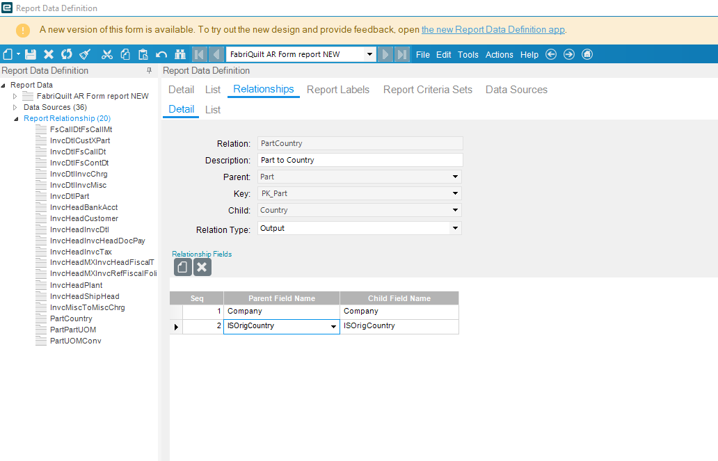

Seems like I just needed ISOrigCountry to CountryNum and not ISOrigCountry to ISOrigCountry. Thanks for the help

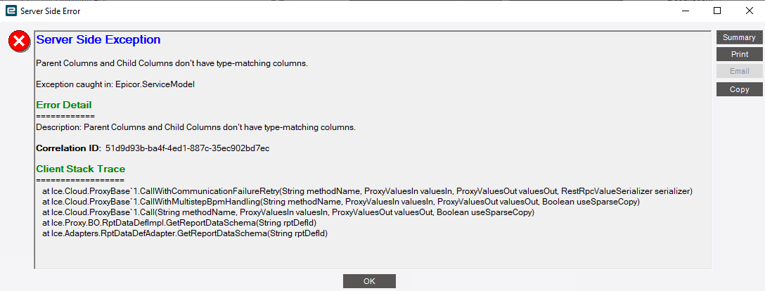

I’m just on it and found out something. It seems those two columns have different data types.
ISOrigCountry is nvarchar(6) and CountryNum is int.
It will work in SQL as long as you will have numeric values in ISOrigCountry but if you want to use it in EDI then it won’t work. I will simply not let you generate EDI definition in for the Report Style
So the relation like this will not work
