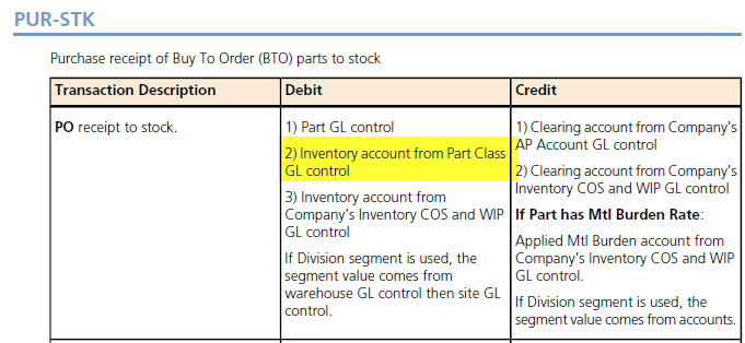

Part Class will override the Company setting for Inventory COS
Edit
We have a Part Class called BTO (for Buy To Order parts), so that they don’t hit Inventory. This is because Accounting is always trying to tie out the Inventory Acct with the Stock Status Report.
  • A BPM automatically sets the Part Class to “BTO Part” on the PO, when it is linked to an Order.
  • When the PO is received, the BTO “inventory” account is debited instead of our actual inventory.
  • When the BTO item ships, the BTO acct is credited, instead of inventory.
