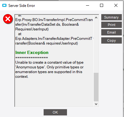

From what I understand, PartAlloc is an in-memory table so I’m getting the exception below. Does anyone know how I can correctly do this? I want to enumerate though the rows I’m selecting later.
var OrderRelRows = (from OrderRel_Row in Db.PartAlloc
where OrderRel_Row.Company == Company && OrderRel_Row.PartNum ==
tt.PartNum && OrderRel_Row.WarehouseCode == WarehouseCode
&& OrderRel_Row.BinNum == tt.FromBinNum
select new {OrderRel_Row.OrderNum, OrderRel_Row.OrderLine,OrderRel_Row.OrderRelNum, OrderRel_Row.AllocatedQty}).ToList();

@Jason_Woods still getting this exception
Could you post your full code?

I know I have some sloppy code in here that I’ll have to fix as well but I can’t seem to get rid of that error

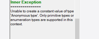

Yeah, it would validate but going to run it generated an exception. It turned out to this line was referencing OrderRelRow instead of x.OrderNum
var cd = Db.CrossDock.Where(x=>x.OrderNum == OrderRelRow.OrderNum && x.OrderLine == OrderRelRow.OrderLine && x.OrderRelNum == OrderRelRow.OrderRelNum).Select(x=>OrderRelRow).FirstOrDefault();
