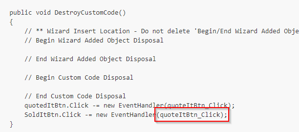

		quotedItBtn.Click -= new EventHandler(quoteItBtn_Click);
		SoldItBtn.Click -= new EventHandler(quoteItBtn_Click);
Literally me right now
Sometimes it takes another set of eyes! :eyes:
Good catch there. Sadly, it still isn’t working.
