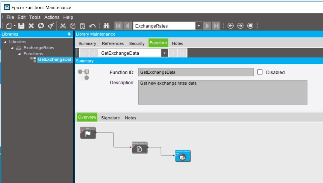

Well what do you know, I figured it out and got my first useful kinetic function working.
Just a simple one but was a good little exercise. Grabs exchange rates from our banks api that returns an XML file, parse that, grab the rates, populate a currExRate tableset and call UpdateExt on the BO.
Now we can import exchange rates on whatever schedule we like
Thanks for the pointers

I can share the broad strokes but not the specifics of how I got the data from the bank and parsed it as that will be specific to each bank \ online exchange rate API you wanted to use and the data that it returns, XML in my case but could be JSON.
But once I have the XML, I parsed it and extracted the values I needed to an array of strings to hold all the info I needed for the 5 currencies we deal in.
Then a foreach loop through that to add rows to a Erp.Tablesets.CurrExRate I defined in the variables in the function.
Once all the data I needed is in the table, I dragged in an Invoke BO block and configured it to call UpdateExt on the tableset.
I then set up a schedule to run at 8:30am (our bank updates rates just after 8am) and assigned the function to that.
Like I said, a simple enough Function but this is my first time using them inside Kinetic. For some reason I have been avoiding it but I’m now starting to understand it and appreciate the power this offers us
