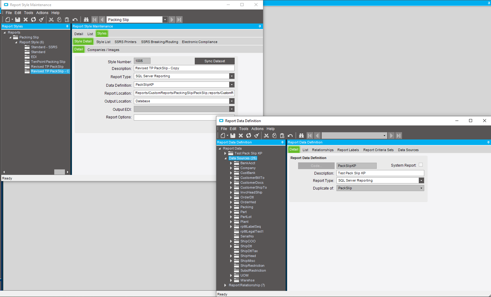

Take a screen shot of the settings for the report style and RDD. I suspect one of the parameter has issue.
It’s not very simple to recreate a standard report from scratch. Why not modify the existing report? Also, use SSRS, not Crystal. Your future self will thank you.
We are in E10.2.200.7, there are two of us that are working on this project and the other person that is working on it is faster with crystal reports than i am with SSRS. I took a screen shot of the RDD and Report Style Maintenance as well incase there is anything that we are missing. please let me know if you want to see any other tabs that are in those two.
