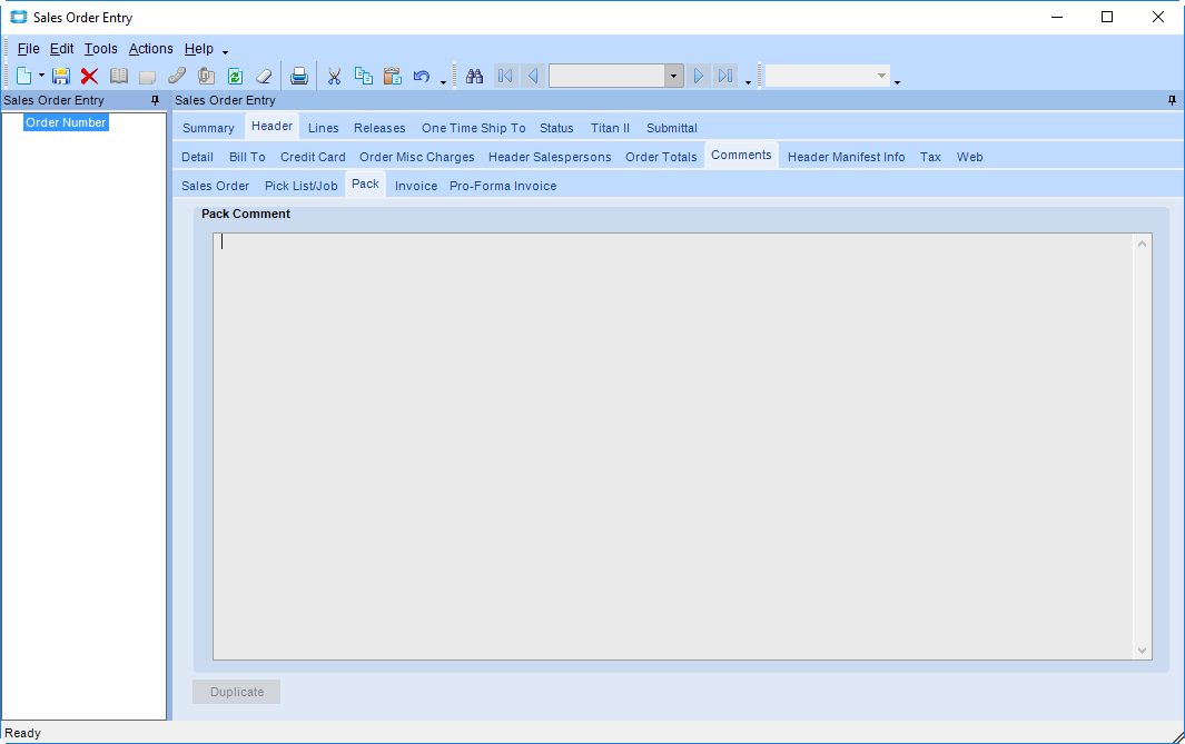

If these are shipments from an Order, you can add Comments to the Order Header that will print on all Pack Tickets.
This needs to be a permanent note for this customer for all of their ship To’s. So preferably not something that has to be entered for every order, but auto inputted.
The solution would be to make a BPM that fills that in for you.
