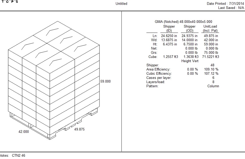

Trying to get an idea of the best way to setup package codes. We have cartons that contain properties of their own, but we also have pallet configurations of how those cartons go on a pallet. Would that specific pallet configuration be it’s own package code or is that not ideal? I feel that might be too rigid, but then i’m not sure how to memorialize that information in Epicor. Anyone out there using package codes that can shed some light on how they have their stuff setup? Our configurations look like this.

Would a Part specific UOM do the trick? The UOM code could be 2x3x8 which indicates both the qty, and the stacking (2 wide, 3 deep, and 8 high)
Still puts us in a bind if the packaging requirements change. Then we are making a new part again. We use Part Specific right now. If I’m going to make vast changes in how we handle stuff I want to try and make it painful once.
