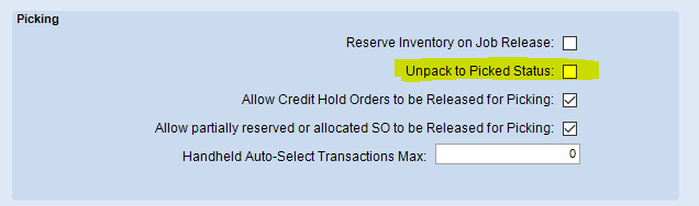

In Site Config → Modules → AMM → Picking
Do you have ‘Unpack to Picked Status’ set to true?
I wonder if this may be causing your auto-allocation when you create a pack. We (unfortunately) process some of our orders outside of the FWB workflow and we don’t run into this issue.
Also is the ‘not enough unallocated inventory’ a hard stop or just a warning you can bypass?
We do not have that box checked although we puzzled over it. It doesn’t seem like it would help?
