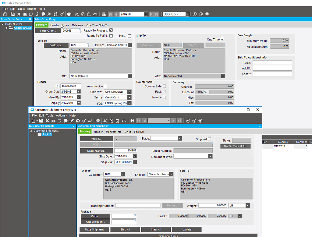

We have had a few customers / SOs in Epicor that were shipped using the default options through Customer Shipment Entry (New Pack, type in Order#, Mass Shipment button -> Ship all button, etc…)
But when the info is sent to Manifest it shows the following -
Even though in the pack in Epicor we have the following OTS info -
Also in the SO -
It seems like it’s only pulling in the customer name, even though we have OTS checked and all filled-out… Does anyone have any ideas on how to troubleshoot this? I’ve checked the database fields and everything seems to be correct.

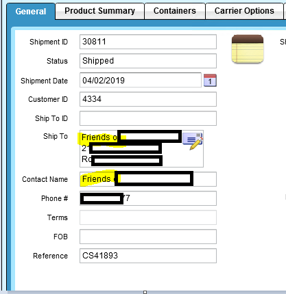

But now whenever we ship an order out with OTS and the customer has a contact on file (not even the primary Shipping contact), then the carrier label comes out like -
OTSName
ContactName
OTSAddress1
Etc.
How can we get rid of the contact name in Manifest flowing into the carrier label? It seems like it feeds into Manifest from the Epicor customer contact, but I don’t see why this would be happening or start happening now; our shipping person has never seen this occur and now all of a sudden it is.

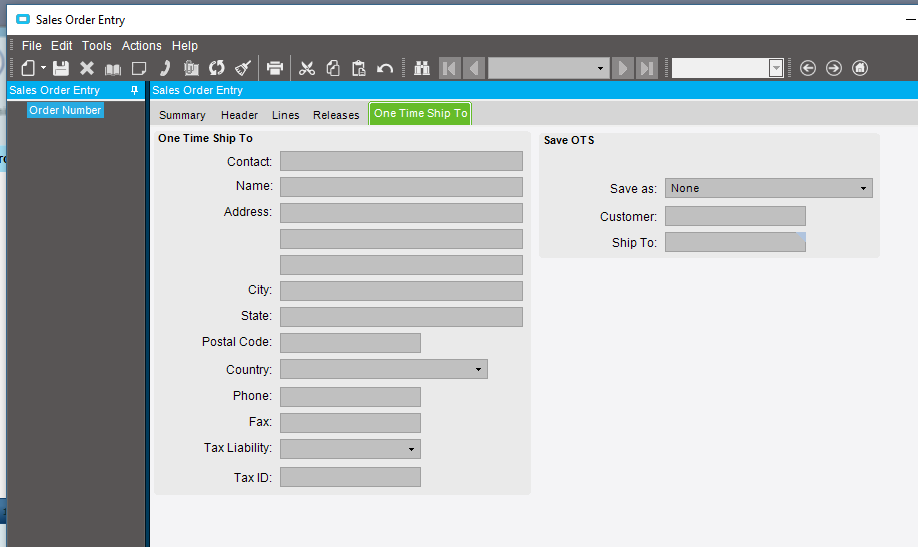

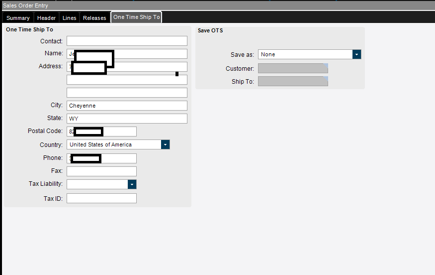

@Caleb323 - what does your Sales Order Entry screen on the One Time Ship to Tab looks like?
Is there a contact name entered for the OTS?
It just has the OTSName info -

I guess this is normal behavior, I just can’t seem to find why some of the shipments have two different names (correct ShipTo name in the ToName area, but the main contact name for the ToCompany area). The ToCompany contact name is coming from the Manifest Customer “Contact” field, but I don’t see why this would transfer over to the One-Time-ShipTo shipments
