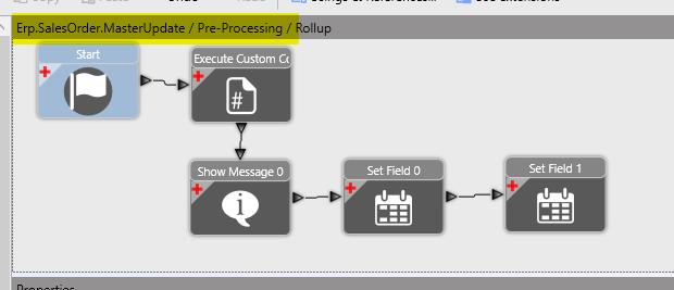

If you’re ok with using code that you don’t understand, the Following BPM Calculates the totals of fields in the OrderDtl lines, and stores it in the a field in the Order Hed.
Two variables:
Custom Code Widget:
and its code
ExtStdTotal = 0;
ExtAvgTotal = 0;
foreach (var ordDtl in Db.OrderDtl.Where(x => x.Company == callContextClient.CurrentCompany && x.OrderNum == iOrderNum)) {
// sub your UD fields that has the Std or Avg price for UnitPrice
ExtStdTotal += ordDtl.OrderQty * ordDtl.UnitPrice;
ExtAvgTotal += ordDtl.OrderQty * ordDtl.UnitPrice;
The Show Message is just for debugging (I display the ExtStdTotal and ExtAvgTotal )

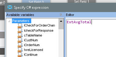

Set Field 0 Widget
(change the target field to be your OrderHed.UD_c field.
Set Field 1 is the same as the previous, but with the expression containing the other variable
