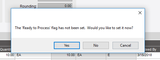

Does anyone know if it’s possible to suppress the message that pops up in Order Entry when you leave the “Ready to Process” box unchecked? I don’t want to default it being checked, either.
Ideally, I’d like to have it be able to be unchecked and be able to go to a new order or exit without that message coming up.

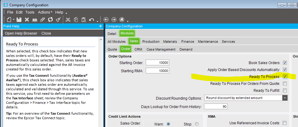

Dear Aaron,
Check this out in Company Configuration:
I don’t think it was there in 10.0 because I specifically looked for it and finding no such control, I ended up installing Dialog Devil on all inside sales computers. My system here is 10.1.600 and it has the option; I think it will do what you need.
I should also mention that the wording of the help topic may imply that the flag only affects Avalara tax customers but alas, Epicor enforces the “warning” regardless.

We don’t want to use that as that will, by default, cause new orders to have that box checked.
We don’t want to have it checked and we want to suppress the message that asks if we want it to be (because we don’t).
In that case, Dialog Devil was the best option I found. It’s shareware from a guy in the UK and we used it to click “No” automatically on the salespersons’ computers every time that box appeared. The user either doesn’t see the box, or sees it briefly appear and disappear. The program doesn’t even lose focus in Windows, at least in Windows 7 which is what we were using at the time.
Because the company didn’t have Avalara, and that’s the only thing the check box controls, we honestly didn’t care if it was Yes or No, just didn’t want to hassle with the box on every order. Hope you find a better solution.
