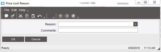

Can we get a scheenshot of the pop up that may help determine where it is. It could be a BPM Data Form.
I did check the BPM’s and didn’t see anything. But I may of missed it. If you feel it is a BPM, I’ll look again and screenshot everything if need be.
YUP that’s a BPM Data Form.
http://jcg.pictures/gdgfiaxH1MoX.png
This guy is where you’ll be able to modify it
