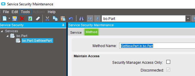

Ive done something similar but on Part Entry. I did it as a service security in security maintenance. you can restrict the method by users.
interesting. See that’s why I ask, I didn’t know this existed! I’ll check it out.

@Banderson the service security gets setup for process. For example, blocking the part.update process stops users from saving changes on parts.
Service security is also how to implement security for the rest api. Bart/Nathan’s novel explains that.
Yeah, I get what it’s trying to do, but fields in the order are changed by other things, so it’s not as simple as the part update process. This might not be the right tool for the job.
service security does work, but if you want “friendly” error messages, you can do the same with a BPM… the BPM can check the value of the security group when someone attempts to save (run Part.Update)… you can then pop up an exception message that says something friendly like “You are not in the correct security group… please contact someone in the Engineering Security group”. Pre-processing BPMs should fire off from REST, DMT, regular UI, or Updatable Dashboards.
I was probably going to ask about that too. My initial testing popped up some less than helpful messages. Not so good when dealing with potentially unintended consequences.
