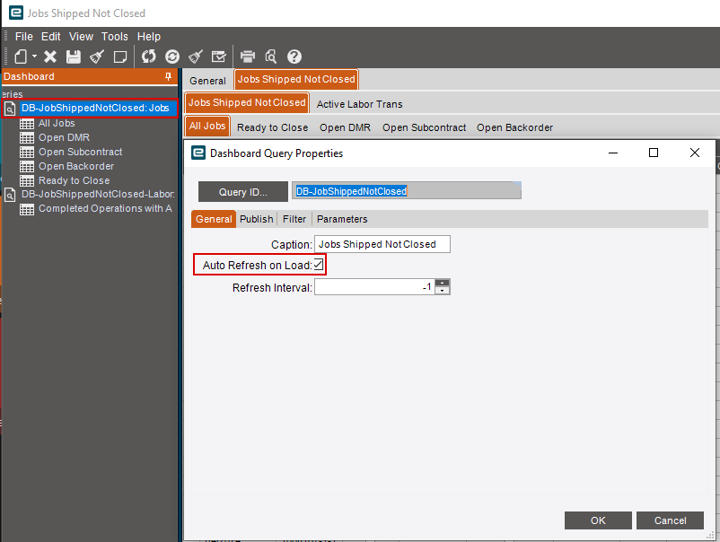

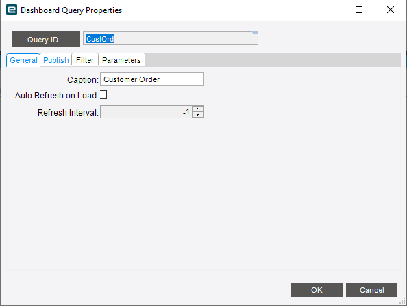

Right-click on the dashboard query and select Properties. In the Dashboard Query Properties window uncheck the box for Auto Refresh on Load.
Hello @THulbert ,
Yes, I already took care of that checkbox; in the classic form, it functions properly, but in the Kinetic apps, it loads data automatically whenever the dashboard is opened.
