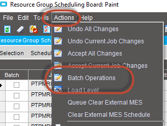

Look into Resource Scheduling Board , Batch Operations. that might be what you are trying to do.
