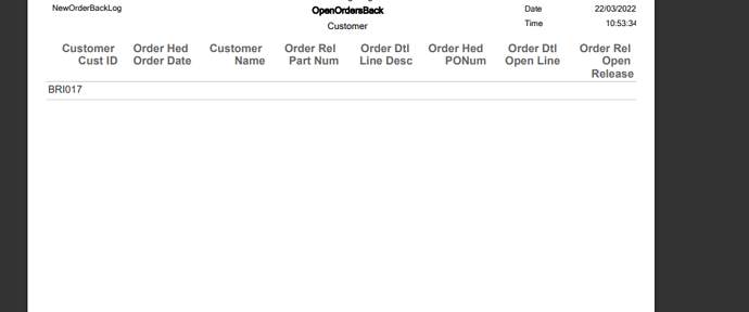

Hello everyone thanks for this I think i have got it working in BAQ form I have then converted it into an SSRS report and pulled in the columns etc but everytime I print preview it just shows the header names and not the values from the BAQ
