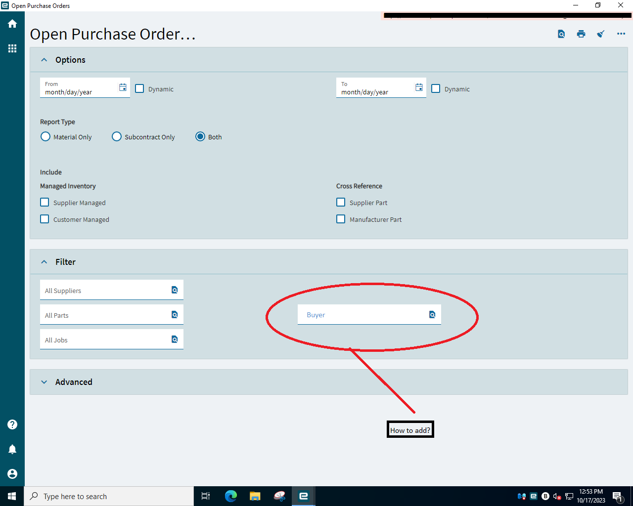

I want to know how to add filters inside Kinetic. I would like to have a filter for a “buyer” so when you run the Open PO report, you get only the Open SO data from that buyer.
Could I get assistance with this or pointed to valuable resources? Thank-you.
(The image below is just a mock up of what I’d like)

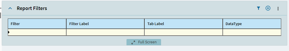

Selecting one gives me where I build one. I see report filers. I click on the + sign to make a new filter. However when I click inside the box it has a vanilla color to it and won’t let me input data.

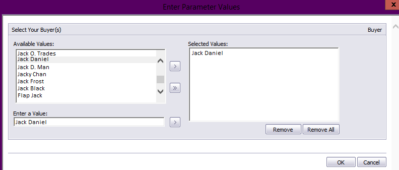

How do I get a parameter to work when you select Print Preview, that a box pops up, asking for a buyer and I set it to Jack Daniel and it gives me all of Jack’s open PO’s? The report doesn’t allow parameters to be exported with it in the report and a separate file like a .csv also does not work with Kinetic, or so I have tried and followed guides. This is how our Crystal report works, a parameter. How do we do this in Kinetic with SSRS?
