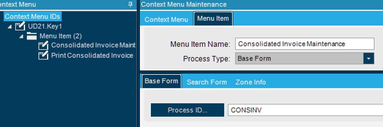

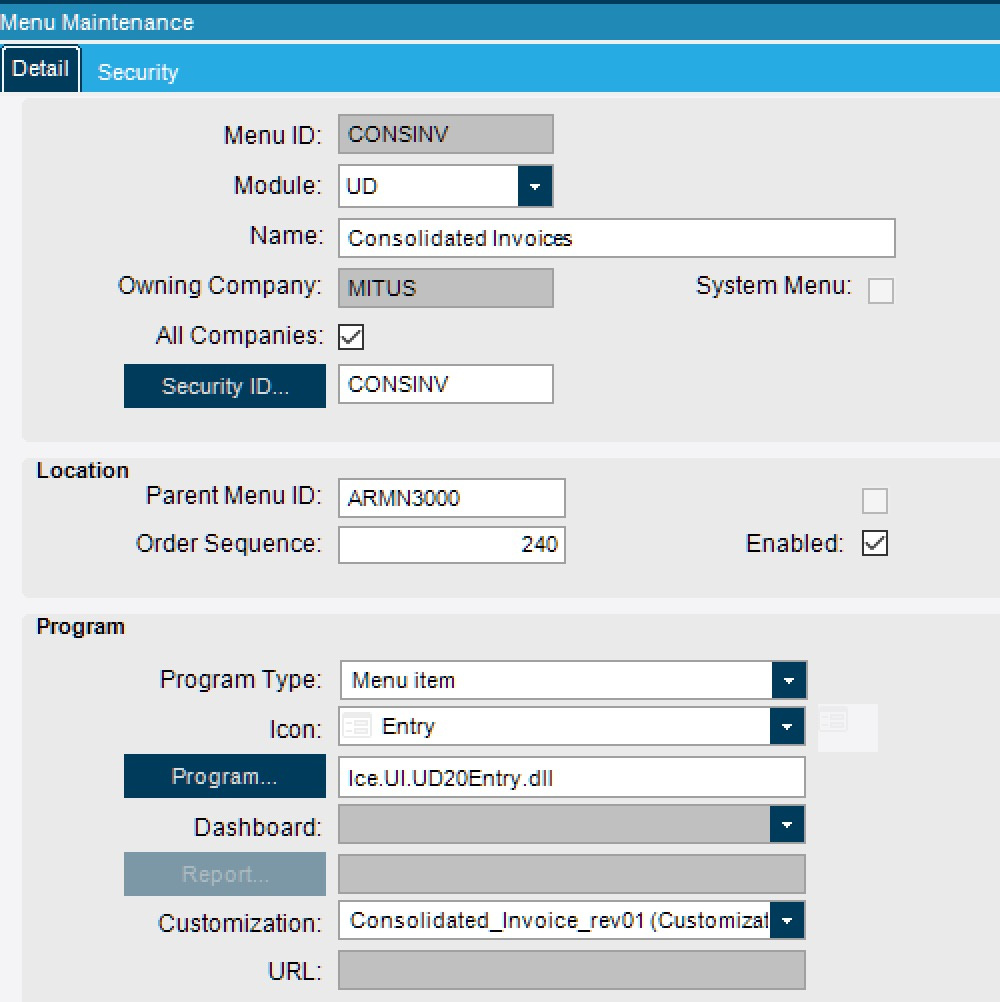

This is an example of how we tied in a context menu and a screen which has a customization.
That sets up the context so that our use of UD21.Key1 (UD21 is a child of UD20) will open the screen which is customized. Any dashbard that contains UD21.Key1 will have those context options. We deploy all dashboards as Dashboard-Assembly, which has always worked better for us than Dashboard-Runtime.
