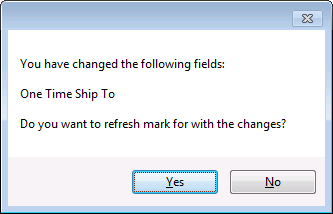

Upon changing a single line on an order to One Time Ship to, I get:
What exactly does “Do you want to refresh mark for with the changes?” mean?

P.S. the warning box would have been clearer if it was
Do you want to refresh the Mark For values with the changes?

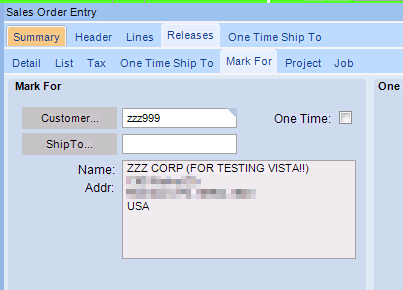

Here’'s the Mark For tab before changeing a release to OTS.
I set the release to OTS, enter the OTS info, and save. On the pop-up, I select NO, (thinking it will keep the Mark To info unchanged)
The Mark For info is update with the info I entered into the OTS.
Selecting Yes on the pop-up does the same exact thing.
