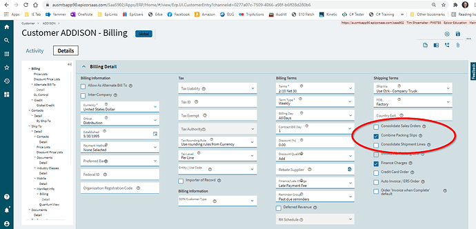

I believe that the settings you are interested in are on the CUSTOMER record. You can enable/disable the combining of packslips onto one invoice. Check out the field help on these checkboxes to read more. Here is a screenshot from Kinetic 2021.1. These same fields are in E10 Classic on the Billing tab.

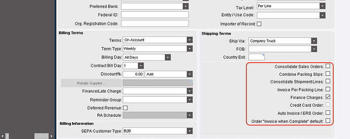

This is how my setup looks like:-
