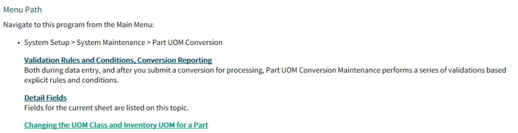

This is probably a dumb question, but I see the path to get to Part UOM Conversion, but don’t see it.
Maybe I don’t have the ‘rights’ to System Setup or System Maintenance?
I’m looking at the home/main menu page after logging in.
It has its own security code and it may not be seen by anyone, but a security manager unless someone got assigned.
If you search for UOM and Part UOM Conversion is not in the list you do not have access.
