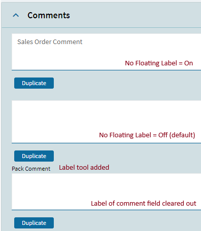

I’m about to clear the label value and add a Label to every Text Area everywhere :clown_face:

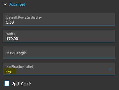

There is an option to turn No Floating Label … but that shows the label until there is text in the field!
Showing three comment fields.
Without text:
Screenshot 2024-04-15 113024
With text:
Screenshot 2024-04-15 113004
The only way (???) to always have a visible label is to blow away the out of the box label and create our own. Apparently…
