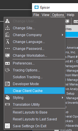

We are on E10.1.600 and our solution to stop Print Previews from showing up for users other than the original person who submitted it was to go into Company Maintenance and change the Print Options to Machine Name + Domain User.
Even after that change we would occasionally have an issue where the Print Preview wouldn’t pop up at all but if we went into the System Monitor - Reports Tab we could see the report and run the Print Preview successfully from there. That wasn’t anything that either clicking on Options - Clear Client Cache or closing out of Epicor and Renaming\Deleting the C:\ProgramData\Epicor\Your_Application_Servername-808 folder (Epicor will re-create this folder when it is opened up again) wouldn’t fix…
Have you tried the Clear Client Cache or re-naming\deleting that EpicorAppServer-808 folder?
