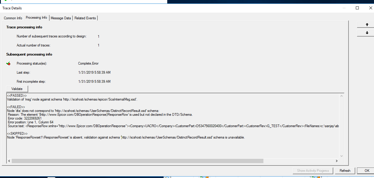

I am attaching the screen shot of output schema.

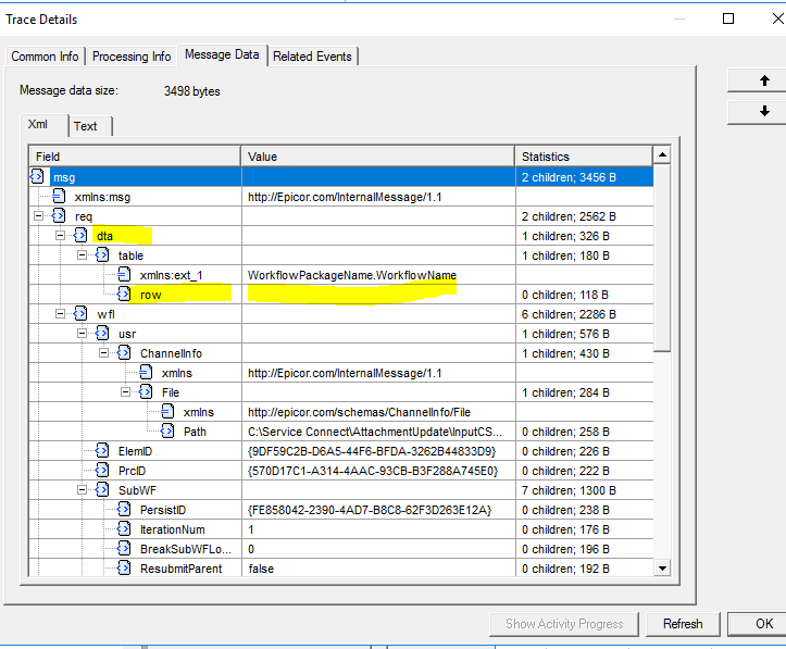

To checking the value is coming i created a conversion with as same as input schema and i mapped the fields left to right with all fields.
After that i paste a field to input channel and inbound tracing i have checked that null value coming in output schema so thats the reason in dynamic also its going the null value.
My question is the value we are able to see on Start level of sub workflow in tracing then why is not passing the value to output schema?
why in output is passing the null value?
i found some error in trace.
how to solve this . please provide some solutions
