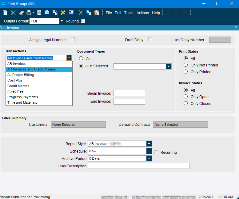

I haven’t explored the other transaction types yet (Project Billing, Progress Payments, or Fixed Fee). Maybe something there?

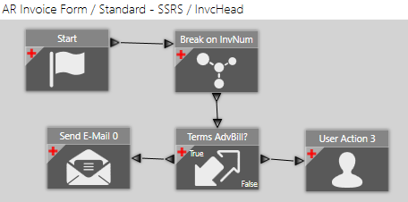

Can you filter them using Print Routing.
Create a print routing rule on your default report style, add a condition or filter to filter these out, the action should be User Action.

@bderuvo - Thanks - That worked great! I had to add a new TermsCode ‘NET 30 - ADVANCED BILLING’. Since TermsCode is a part of the InvcHead data set, this was pretty easy! The normal invoices can still be Print Previewed, and the stifled invoices now get emailed.
