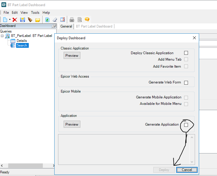

Generate Application is disabled for me. I remember there being a trick to getting this to work in 10.2 or early 11, but I don’t remember what it was. So I can’t, as of now, convert my dashboard to Kinetic
Mine is greyed out too! do you know the trick?
