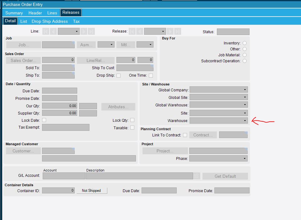

That makes sense. What I am trying to do is the following: If Partwhse.checkbox01 = true then select partwhse.warehousecode. Checkbox01 designates the warehouse where we receive parts into. Can you help me with the customization code needed to do this on PO entry?
Do you mean Receipt Entry, or are you sure you are trying to customize PO Entry? Where do you want the combo box? What grid do you want to highlight the row in?
PO Entry. The box already exists and populates based on the prime warehouse. We have a non-prime warehouse that is “stocking”. PORel.WarehouseCode is the field I’m trying to customize to fill in the warehouse based on the true value of partwhse.checkbox01.

Ok. Thanks! Hopefully someone can help. I have the code for receipt entry that works as intended. I just need to apply this same concept to PO entry.
It looks like the only parts of your ReceiptEntry function that would need changing are wherever it uses edvRevDtl: your source of the PartNum. You’ll substitute in the equivalent that you have for POEntry, and it should work similarly.
