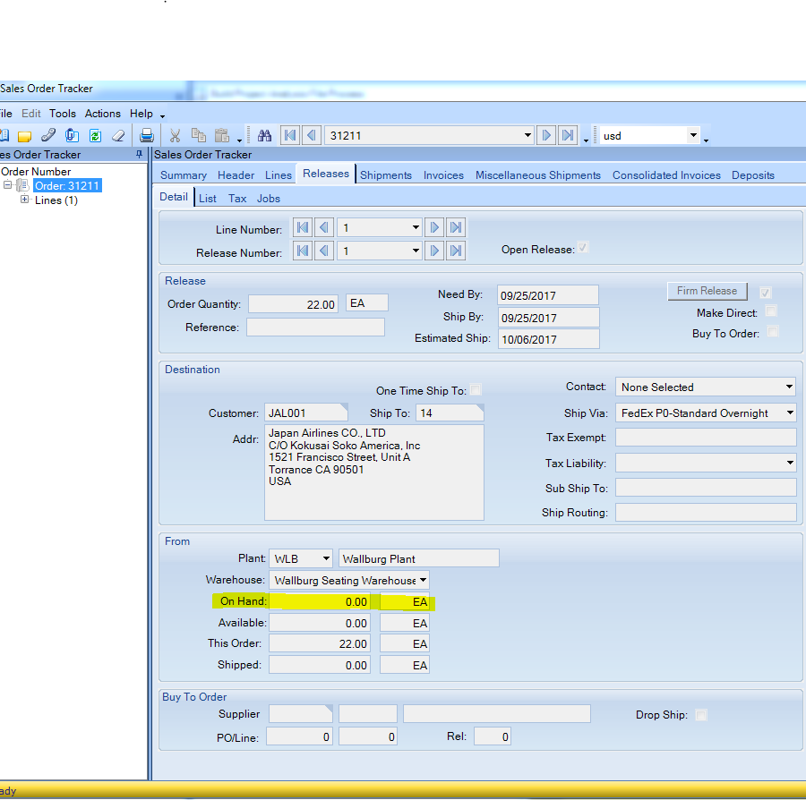

The SO shows non on-hand but I thought since a Non Nettable it would not show it.

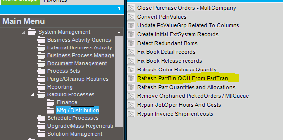

Also, I’m on E10, but we had to run a maintenance process once when our QOH’s got out of sync with Part Tran history. This must be such a common problem, because the added it as a menu item right in E10. :wink:

We don’t have this in E9.

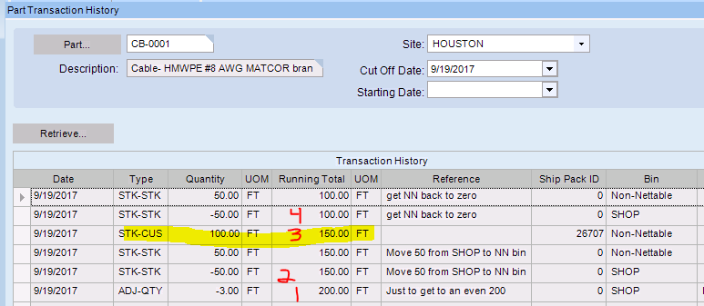

A test in E10 shows that the Running Total column of Part Tran History excludes qty’s in non-nettable bins.
Referring to the red numbers in the pict below…
  1. QOH was 200. It was all in bin SHOP ( a nettable bin)
  2. A qty of 50 was transferred from bin SHOP to bin NN (a non-nettable bin). Running Sum goes down by 50, even though the Qty is on hand
  3. A packer is created (and marked SHIPPED) with QTY of 100 coming from bin NN. the Running Sum remains unchanged. Referring to Pict 2, the QOH of Bin SHOP is 150, bin NN is -50, for a total of 100. This is correct (we had 200 , then shipped 100), eventhough Part Tran Hist shows 150.
  4. An Inventory Transfer is performed to move 50 from bin SHOP to bin NN. Afterwards, the Running Sum correctly shows 100. (The top two lines in the Tran History are from the same Inventory transfer operation)
