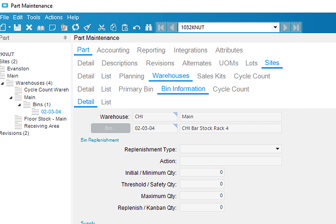

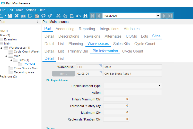

One other place to associate with bins is the PartBinInfo datatable. This can be populated with default bin information if you like. you could store multiple bins per part here, even if there is nothing on hand. This is done through the Part maintenance program, and adding the bins on the Part/Site/Warehouse/Bin tab. You dont have to add any additionl information if you dont want to.
