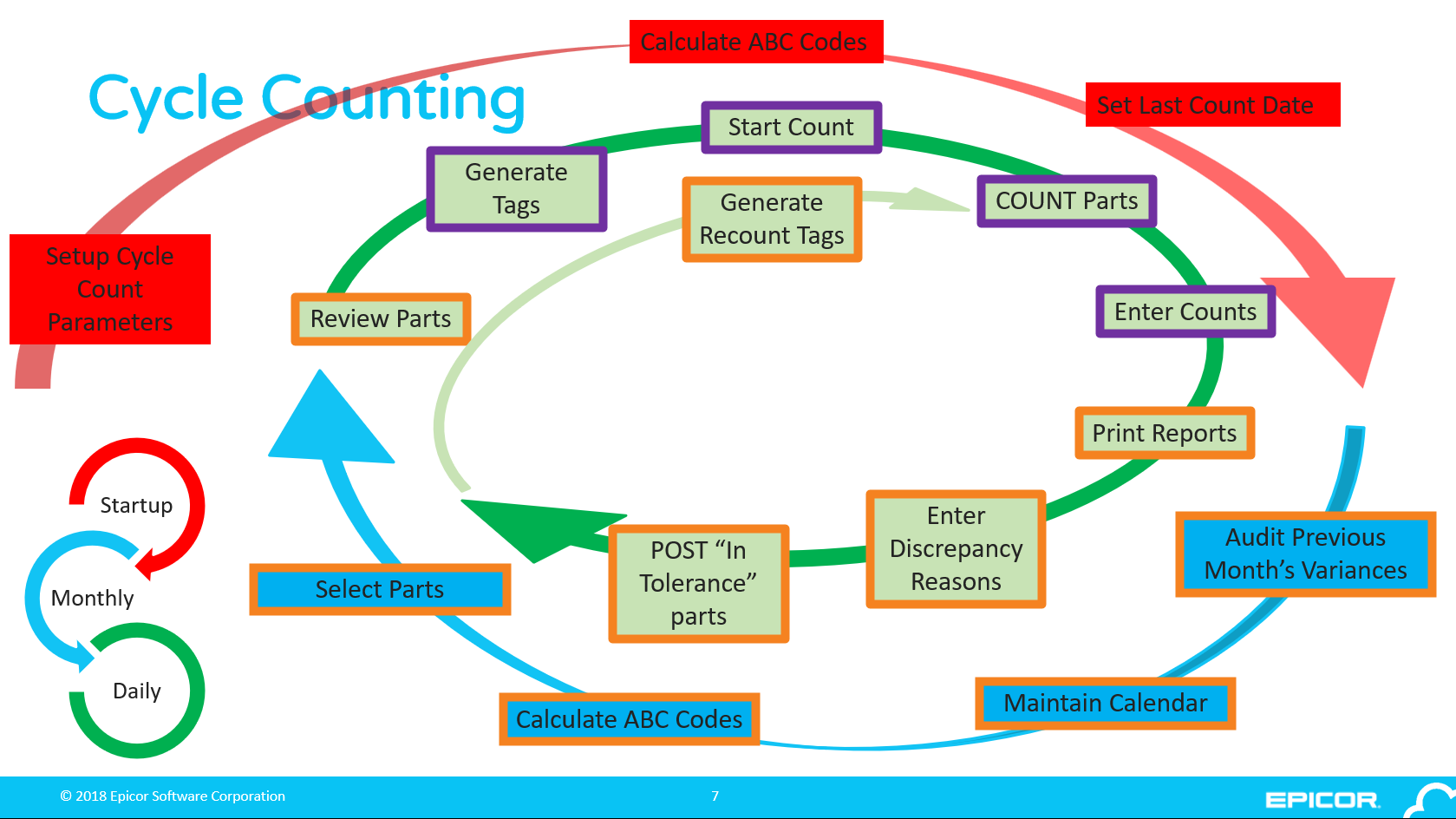

Cycle Counting and Physical Inventory are very related in Epicor ERP and have been for a very long time.
  • Cycle count is designed to do a regular (daily, weekly) count of items, spreading out the physical inventory process, and even multiplying it out so that you can do multiple counts during the year. The count is done by “experts” who really know the stockroom, and understand how to count
  • Physical Inventory is a “big bang” where you count everything in the warehouse all at one time. Because it is a big bang, you have to bring in outsiders (shop floor workers, sales people, IT Managers :slight_smile: and maybe even temp workers to count. These outsiders dont really understand the difference between a “count of 2 spool” and a “count of 100 feet on 2 spools”, which leads to huge errors.
Within Kinetic, if you want to run a complete physical, you still launch the cycle count program, and click the checkbox for a complete physical. Outside of that checkbox, the process is nearly identical to run a count. Our Count process is described by many as “complex” but it is also auditable, and trackable. It allows you to start the count, process, print discrepancy reports, enter discrepancy reasons, and then even generate recount tags for those items that are out of tolerance.
Below is a picture of a slide I created years ago for a user group meeting that describes the process… note that there are three main colors. Red is startup, Blue is the "monthly (or periodic) step, and GREEN is the daily steps. The boxes outlined in ORANGE are more Administrative, and outlined in PURPLE can be done by the stock room staff.
