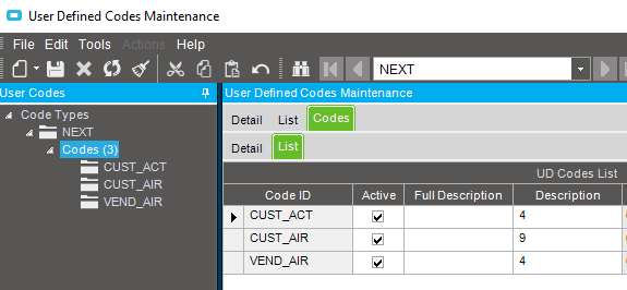

image.
This shows that there are 3 existing customers with ID’s starting with “ACT” i.e ACT001, ACT002, ACT003 and 4 Vendors with ID’s AIR001, …AIR003.

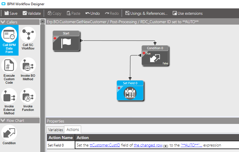

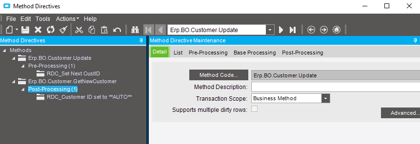

It took me quite a while to work out the coding to achieve my aim but it consists of 2 x Method directives for the Customer Table and 2 similar directives for the Vendor table.

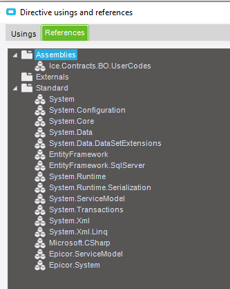

The directives use the following usings and references:

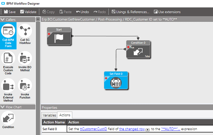

The first Post Processing Directive above is based on the GetNewCustomer BO simply fills the ID field in a newly inserted record with the text “AUTO” and the second Pre-Processing directive with custom C# code below is based on the Customer.Update BO does all the heavy lifting of allocating and updating the Customer ID once the Customer name has been entered.
In order to make a sensible set of Prefixes for each customer e.g “AIR001”, the prefix being “AIR” I have set the coding to remove any non standard Characters such as punctuation, *, & etc… which may well exist in the customer name as entered.

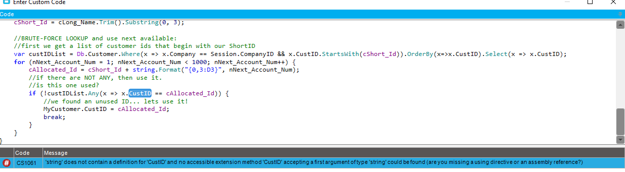

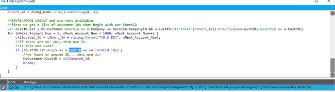

You could eliminate the entire UDCode section just by looking for the next available number… the way I did it below was a “brute force” method… simply looking for one that doesn’t exist yet… benefit here is that it will fill in the blanks as it goes.
so the entire code block is much smaller… doesn’t need any scoping… doesn’t do any database updates or creates. It only does the one query against the customer table to find a list of all the customers with the same prefix… then it scrolls to find one that is not used.

    cShort_Id = cLong_Name.Trim().Substring(0, 3);
    //BRUTE-FORCE LOOKUP and use next available:
    //first we get a list of customer ids that begin with our ShortID
    var custIDList = Db.Customer.Where(x => x.Customer == Session.CompanyID && x.CustID.StartsWith(cShort_Id)).OrderBy(x=>x.CustID).Select(x => x.CustID);
    for (nNext_Account_Num = 1; nNext_Account_Num < 1000; nNext_Account_Num++) {
        cAllocated_Id = cShort_Id + string.Format("{0,3:D3}", nNext_Account_Num);
        //if there are NOT ANY, then use it.
        //is this one used?
        if (!custIDList.Any(x => x.CustID == cAllocated_Id)) {
            //we found an unused ID... lets use it!
            MyCustomer.CustID = cAllocated_Id;
            Break;
Tim,
As you are one of the people who has helped me in the past, and I snaffled some of your code as the basis for my work, thanks very much for your input.
I am just trying to get my head around the code logic at the moment though as I am not really a Linq expert by any stretch of the imagination! Still, my version did work and I’ll certainly implement your code as it does seem to offer some distinct advantages if I understand correctly, like filling in any missing ID’s in the sequence for each UDCodes entry.

Tim,
I had a couple of syntax errors in the Brute force code you sent, mainly the Company ID in the Customer table and the break command having the wrong case which I have fixed, but I can’t see where the only error left is coming from and what the error message “string” does not contain a definition for CustID and no accessible extension method CustID … . Any ideas please? As I said, my Linq skills definitely need some polishing up!
Sorry about the typos… The code all came out of my head, and I never validated it with an editor…
Try changing this line, adding the “NEW” statement to fix your string error.
var custIDList = Db.Customer.Where(x => x.Customer == Session.CompanyID && x.CustID.StartsWith(cShort_Id)).OrderBy(x=>new{x.CustID}).Select(x => x.CustID);
Tim,
Sorry but same error and I can’t figure out why.
OK. the reason was I gave the wrong solution… I just put this into a BPM, and found the errors. Here is the completed code.
Note that I also added the “CST_” at the beginning of the ID also. I did some additional clean up and optimizing.

Thanks to Tim for the help and Marjorie, yes Tim’s solution does mean that no UDCodes need to be set up as and unused/deleted or deprecated ID’s can be easily recycled. If you noticed, my original code actually creatted the UDCode records automatically so no outside processing was required.
However, I am keeping the UDCodes “master index” as I have additional BPM’s that will use the data held there for other purposes but I have incorporated Tim’s LinQ solution for allocating the ID to the CustID field to get the best of both worlds. I will post the final code if anyone else is interested over the next few days.
