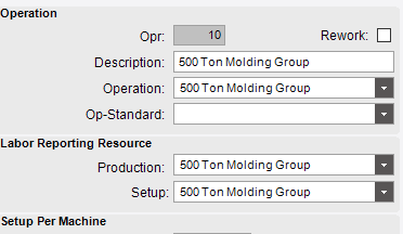

I was asked to make a new resource group (650T) for a molding press. About 20 existing parts needed to be moved from 500T to resource group 650T.
The resource group was made and the parts were updated to use the new resource, I went into Engineering Workbench and updated the Operation and Materials to use 650T.
The issue is, the new jobs after processing MRP still come up with 500T as the resource. I have ran a regenerative MRP and still no change.
What do I need to do for these parts to use the new resource group with a new job?

Did the scheduling resources actually change on the method? I would check that.
I tried creating multiple jobs from scratch to see if all parts are coming up with the old resource and it looks like it is only some parts. I went and re-did the changes and re-approved the revision.
